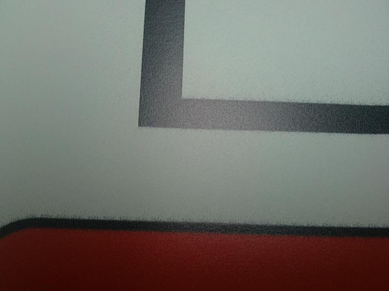

Hi guys
having trouble with overspray, but seems only on the black head
anyone knows why?
thanks
running sp-300
MikePro
my argument against the static theories is always why would it be isolated within a single head?
better question is, how old is your printhead?
have you tried a long soak and/or an ink line/head flush?
noted: posted this in another thread, but a good heavy cleaning has fixed it or me in the past. Overnight soak followed by a line/head flush made my day when I started printing right again!

what does your test print pattern look like?
I'm doubting the static too on just one head, but check your humidity.
Did you do a visual check of the heads and the path they travel (no little bits of tape sticking up). Did you do a manual cleaning?

Had this on black only a few weeks ago and a fresh cleaning fixed it up.
sfr table hockey
wipe the media down with some isopropal and re print. If its gone it was static.
I have at times had just black show the static as there must have been a heavier spray for the black I used and just enough difference to show on black only.
Or try another media as some tend to be worse for static and in the winter you will see more issues.

yes the black test print is bad but has been like that for a while... I will look under at the head...
