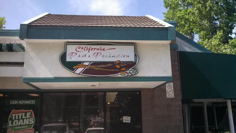

For all those who insist on using calendared vinyl for back lits because it works and is cheaper...
Good luck with that mess.

I made that...
They had asked if I could make it where the sign would age/weather faster to make it look like they had been in business longer than they had...
I told them I could, but it would cost more, as aging vinyl is a bit more expensive.....

Anybody ever have this affect from using a quality vinyl like the 3M translucent series? It's happened to me before, but not sure if it's from perhaps facility maintenance cleaning the building faces with possible detergents or pressure washers, or the client using chemical to clean?

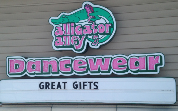

I can remember about 20 years ago when a guy I knew was telling me what a great discovery he made when he noticed that regular calendered vinyl was translucent, how much he was making using it and charging for cast! I did end up trying it, we had a customer who did temporary electric faces for promotions and the stuff actually looked pretty good, but it was only up for 6 months at a time. The place changed owners and the new guy didn't use us and left the last special face up for years, looked like this after a while.

I often see reds peel/crack/fade/etc first
edit: dont know info about age/type/etc of this face, I just surveyed it last year, hence the photo :thumb:
