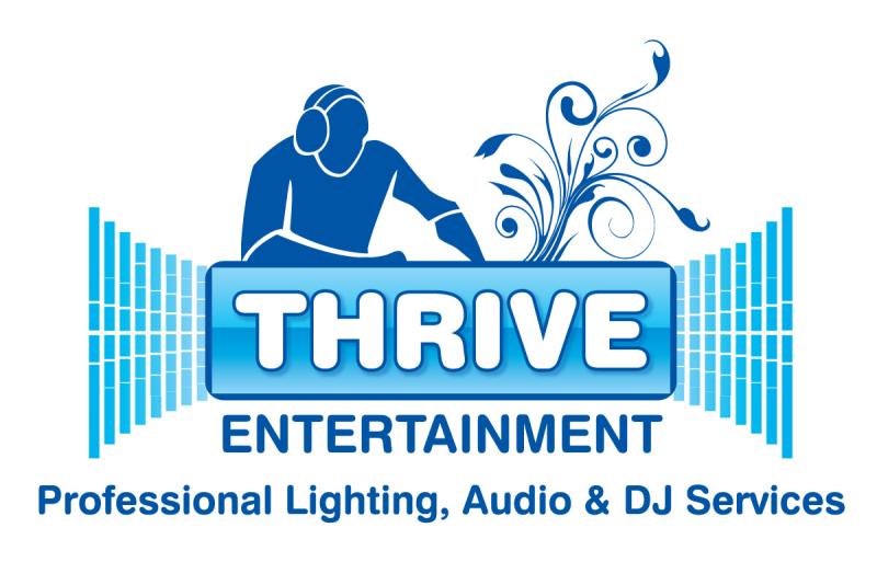

I'm having a tough time with this one. It's a guy who does dj, audio and lighting for weddings and other parties. He likes blue, swirls, wants something modern, not femine, not too formal, not too casual. He wants wedding business but wants to appeal to more than weddings. I came up with this and I have some issues with it, but I'd like to hear what you guys have to say first. (This is easily converted to 1 color. Did it that way first but here you're seeing the bells 'n' whistles.)
Thanks!
Edit: The name THRIVE comes from the fact that he started the business with nothing and now it's Thriving.

The swirls coming off the turntables should have musical notes on them, not flowers. Only thing that stuck out to me.
signgal
I agree with Pat and I'm not sure why your box has rounded corners but the inline has square. I like the idea of using the totally "in" swirl effect though. That will appeal to women and the blue is good too. Maybe the "in your face" volume bars are too much. That's all for now.
GoodPeopleFlags
Eww! I don't know why the inside rectangle corners are showing up square, either! They're not supposed to be like that.
Love the idea with the music notes. Why didn't I see that? It's so obvious now! I'll work on that tonight.
I was thinking that I may have too many things going on, with the guy AND swirls AND the volume bars.

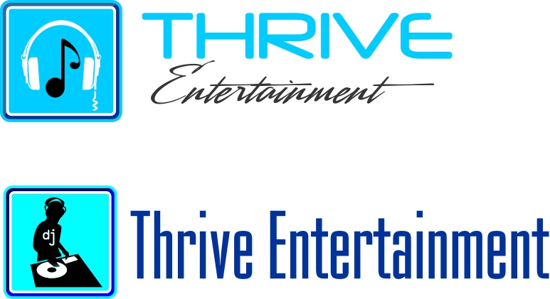

Here's some other ideas I was working with before I came up with the one above.

music notes in the swirl was actually the first thing i thought of when i looked at this, the next thing was a font change...i think it works the for the "thrive", but i would using something different for the rest of the text.....the "professionally....." line could definitely be made smaller too....

Any suggestions for the font? I really struggled with that for a long time and am still not 100% happy with it. The whole thing is so busy that I wanted to keep the font clean. All suggestions are welcomed!
Craig Sjoquist
1st thing I saw was the thrive font all of the copy is the same font no contrast you have all rounded ends font try either main name copy or bottom copy with squared ends.
yup musical notes, the sound wave bars could fade maybe, your eye kinda goes to them and look like speakers so not sure.
The other 3 nope what you got is way better and really like it. great start.
rjpjr
1st impression... the character looks bored.
Only after studying the logo and reading all of your post did it become apparent to me that the character was a DJ.
Also, IMHO the logo looks lopsided with the DJ offset to the left. Maybe center him up and make him look like a symphonic conductor controlling all of the lights and sound.

It's too busy. The black one, top left in post #4 is much more professional.
If Thrive is a recent idea to change the name... get him to change it again. All I can think of is gum.

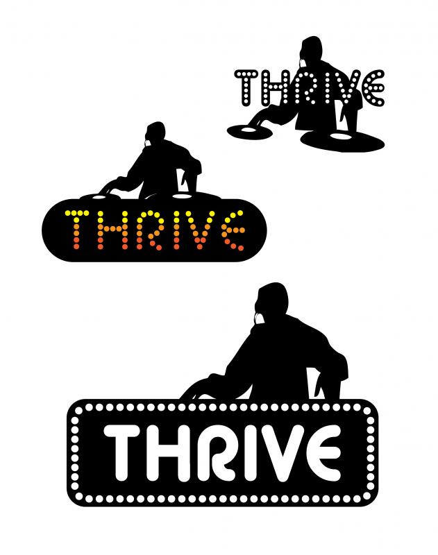

I think the idea of music notes is great and the DJ does look like he is resting, making it not so obvious that he is a DJ. The other thing is that nothing represents the "lighting" aspect of his business, which it might not have to. Instead of the stuff on the sides I was thinking adding circles around the boarder, much like marquee lighting, or in the letters, or possibly as the letters

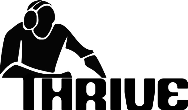

I think a simpler approach would work better if trying to for a logo and not a sign.

TheSellOut
This is what I was thinking when I said marquee lighting!
