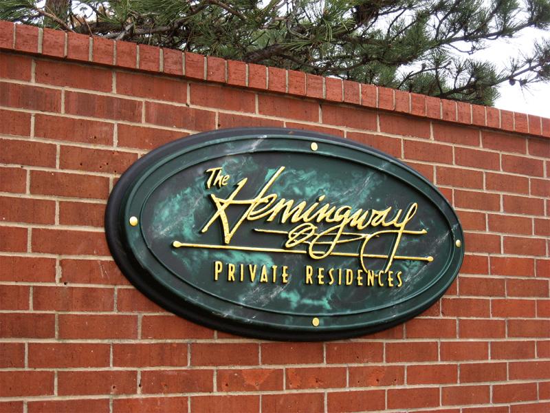

This is a routed sign on the CNC. I ended up gilding the letters. I'll post a photo showing the final project.

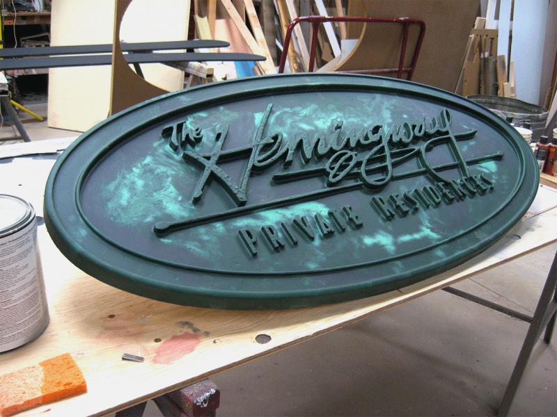

With this panel I wanted to give the impression of a not too clean signature done by hand. On the letter surfaces I applied texture to make the gold sparkle. The marbleized background was poured on automotive enamels given a little swirl with chopsticks. Chopsticks are an essential at my shop. I'd have to close her down without them.

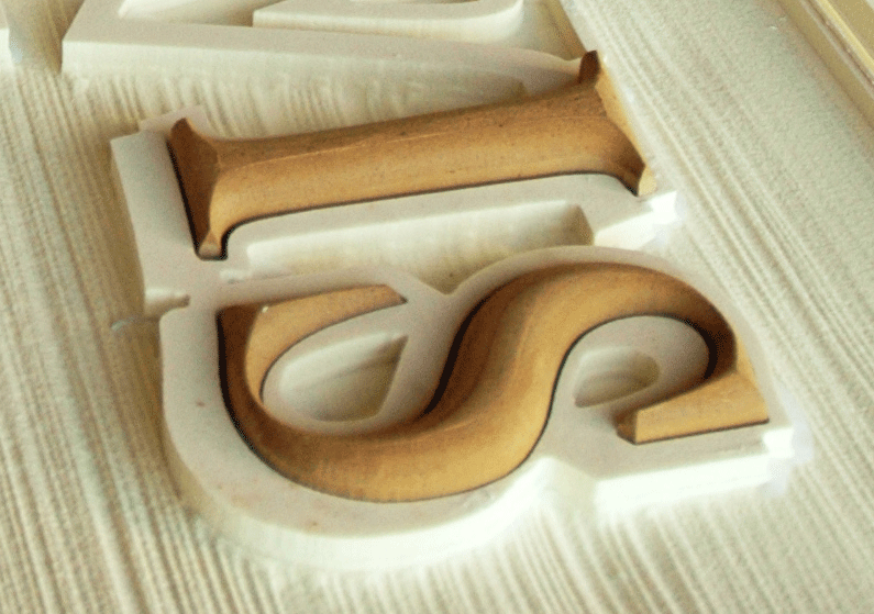

WOW folks, let me take up for Extira.
For the past six years I've used this material on my router for carving letters. I try to stay away from HDU letters because if you drop one it's going to break.
Jill is correct about the issue of paint sticking but this can be easily overcome. There are two ways. On larger flat panels you can scrub them down with soap and water. This makes a perfect soft fuzzy surface that paint loves. When cutting letters I quickly paint on a light coat of shellac. That does the trick.
This is a dangerously heavy board. I can no longer manage it by myself. This isn't a material for all sign shops. As a matter of fact, it's only good for router folks.
Here are some HDU letters that were ready for paint. They are pocketed in the HDU board to make them secure.
