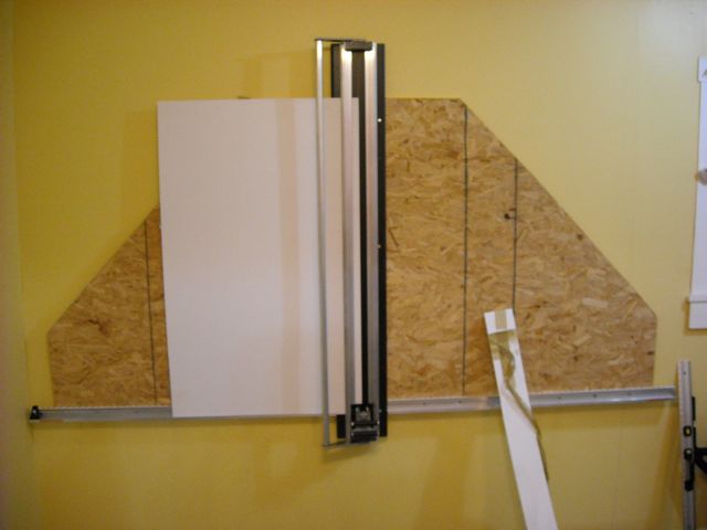

So of course being male I didn’t need the instructions after all I knew what I was doing! Initially I slid a piece of corroplast into the cutter and cut it as it was laying on the table. It cut all but 4 inches of it. Hmmm 10 minutes later I decided it probably was better if I read the instructions. Good job I did. The cutter is designed to cut to the end of the substrate but it needs to be put together correctly hence the need for the instructions. I have to say the instructions are very well laid out. Easy to understand. I only had to call Charles at Kooto with one dumb question. The Machine has a bar that holds the substrate into place. The machine is also either right or left handed but I couldn’t see which was which. I would prefer to see something to indicate this either in the instructions or on the cutter it self. A quick call told me all I needed to know. The handle as its shipped goes to the left hand side that’s it setup for right handed people. With minor adjustments the machine can be set up for left hander’s as well.
So now I knew what I was doing. I had a piece of 4x8 of OSD and decided to make that the back board for the cutter. The instructions offer both an A and a B option. I the back board was the B option. After ensuring all was straight and aligned as per the instructions I screwed everything into place. Added supports to the rear. And we were ready to do a test cut. Placing once again coroplast into the machine I did a simple cut. And it cut beautifully. So next step was to get the Tsquare out and to see just how square the cut was. I am very happy to say it was spot on.

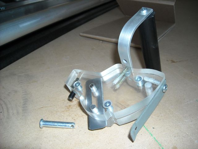

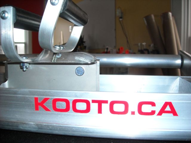

Next step was to see what blade it took (kindly noted in the instructions) I but im a curious-kind-a-guy. There is one pin that’s easily pulled out to enable the cutting element to be removed. (as seen in the photo to the left. The pin is above the second “o” in Kooto This slid out smoothly. The blade is then held in with 2 pins. I used a drill piece I had laying around to simply push each one out and the blade simple fell out after that. Very easy no issues what so ever. It didn’t have the blade I was expecting to see. I was honestly expecting a carpet knife/Utility blade. But this one is perfectly adequate. So my curiosity being quenched I immediately put the blade back in. Taking the usual precautions of handling a sharp edge. (kids take note ☺). Again this was a painless thing to do. After the first pin was back in the blade pivoted and was easy to get the second pin in place. So with that now done I measured and installed my new cutter onto the wall. The only place I could put it covered up a never used plug so no issue there. So now the cutter was affixed proudly to the wall. So how would it work in situ.
Well it worked very well. It cut everything I could throw at it. It has a great stop gauge to making repeat cute quickly. I even got a little surprise. To cut you go top to bottom and it works great. However running the blade bottom to top I found that it actually could cut allupanel (to be honest it did take a lot of passes, and its not designed to do that) but it did eventually do it. And at $299 plus shipping and tax it is great cost effective addition to the shop. Am I happy I purchased it? Yes for sure. Would I recommend it yes. Especialy if your starting out and are on a budget and cant spring a couple of thousand for one of the bigger named substrate cutters. Is it well made Yes it does appear to be.
