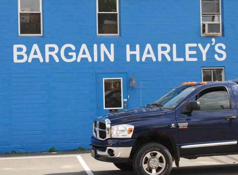

Sunday was spent standing on a plank with a brush in hand. I used One Shot lettering enamel. Smells and acts just like Tremclad but has way more pigment in it. I only needed one coat. Must have used 4 or 5 ounces of paint total. Good stuff. I found it got thick in my paint tub so I had to keep thinning it as I went along. A smaller can would probably have helped there.

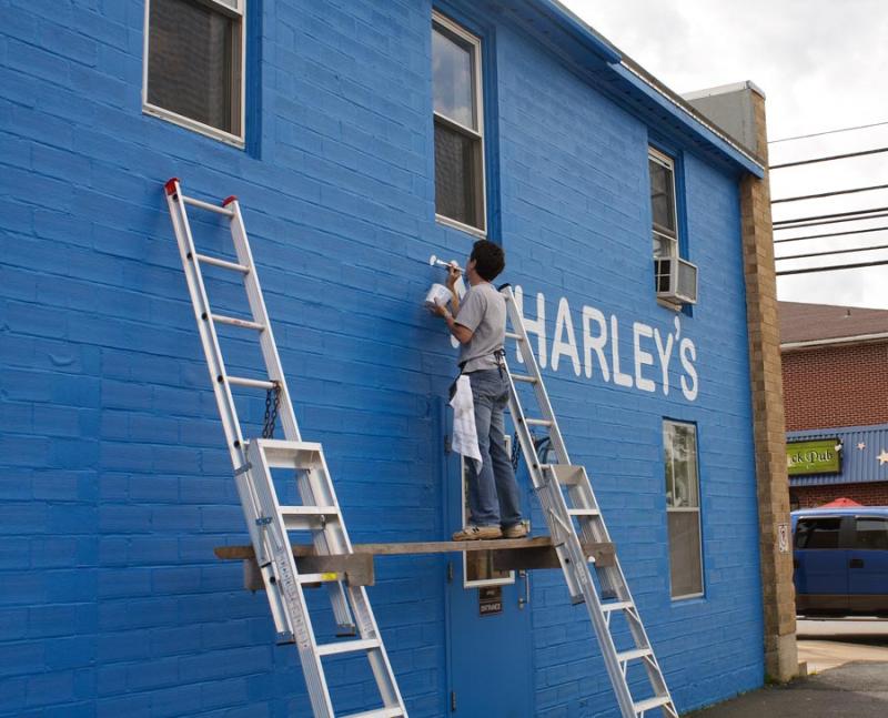

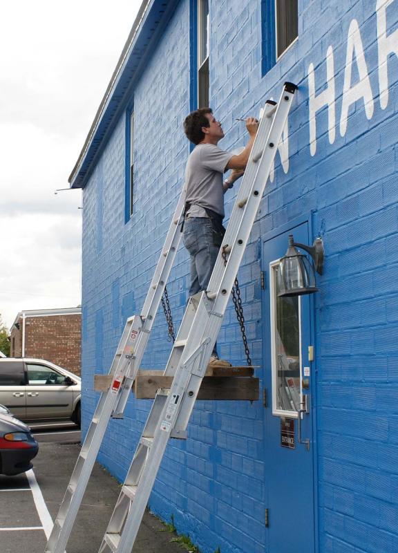

I had quite a few passers by ask about my ladder jack "staging" so I included a pic that you can see it fairly well for those of you who aren't familiar with it.
I also had one really old guy tell me that my "S" was upside down. He seemed to really get a kick out that.:rolleyes:
The job took 5 hours to paint. Probably spent an hour messing with getting my patterns made. I made most of the letters out of bristol board. I made the E out of the L pattern and the H out of the B etc. to cut down on the number of patterns I had to make. I taped the patterns in place and drew around them with a pencil. I lived in terror for most of job worrying that I would look up at the end and see "Hargain Barley's"

I made a set o ladder jacks with chain once. I didn't like the way they tend
to swing. What kind of brush did you use? Looks good!

what kind of ladder jacks are those. I don't think thy are OSHA approved.
looks good tho
Craig Sjoquist
Major Contributor
Home made ladder jacks gees well it worked, but siding suppliers have really nice ones very adjustable Aluminum even todays prices should be well under $100..I also understand they are not used much ... I like scaffold better, but when needed jacks are great

Good job ... only criticism is that the rounded letters such as the G and S should extend a little above and below the flat letters ... otherwise they ted to look smaller.

I have had my ladder jacks for 25 years at least. They are made from 2 x 6 Hemlock. The eye bolt for the chain goes all the way through the 2 x 6 and the eye is welded shut. I used to use an open hook to secure the chain in use. When I got them back from my brother after he borrowed them he had replaced the open hooks with those threaded take-apart chain links. (he also lost one... I used to have 3) I thought that was a good modification.
Anyway, I can get the folding ladders, a ten foot plank and my jacks inside my van and close the hatch. Something I can't do with scaffold. (which I also own 6 sets of)
The jacks won't swing if you set them up so the plank lies flat on them. Especially since they are wood.... lots more friction than aluminum jacks. If you're real Nervous Nelly you can drive a screw through the plank into the jack.
When I did siding we had steel jacks that weighed a ton..... and they were wicked cold on the hands setting up in winter. I much prefer my wooden ones.
