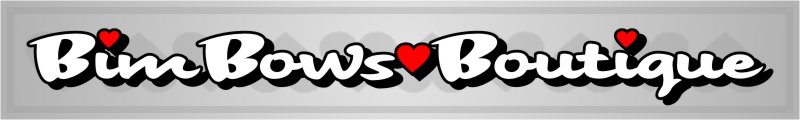

Here's a quickie.
I'm not a fan of using such a dark drop shadow normally but this would allow you to give her the colors she wants, black, red, silver.
Love.....Jill
PS
I have a cousin nicknamed Bimbo. He's about 55 years old and would kick the sh!t out of anyone who would tease him about his name!

bob
Here's a quickie.
At first glance your alternative reads 'Bun Bows Boutique' in that cartoon type face. The 'i' and 'm' in 'Bim' take on a configuration pretty much indistinguishable from the 'u's in 'Boutique'.
If this this is supposed to be legible to normal vanilla earth people, lose the balloonesque type and set it in something that has a much lower ambiguity index. The name itself is sufficiently tasteless and cutesy** without compounding it with dubious type selections.
**The lifespan of businesses with this sort of name is usually measured in days, get paid up front.
Malkin
I had the same thought as bob (first time maybe?) that the "im" appeared as "un". If this particular typeface was used I might edit that vertical stroke out of the "m".

heyskull
Jill
That looks real good.
I'm gonna talk her out of the CND logos as it would look stupid.
