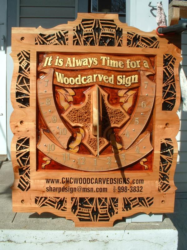

Just wanted to share a photo of my sign I'm hoping to get hung this weekend when the time changes. I need to re-paint the garage gable first and it's still freezing nights :banghead:.
It's 2x6 redwood, designed in flexi, dxf'd into V-Carve Pro, on into Mach3 and then carved on my Joe's 4x4 R&P Hybrid. Was a fun project :wink:.

WOW, very detailed!!!!
Love the sundial connection with your biz name......cool!
Couple of questions if you don't mind......what size is it and why did you have the laminates going across the sign instead of up and down? Will this beauty hang or be attached to a post?

That is very intricate. Do you work mostly with redwood? We used to use redwood regularly and then switched to mostly HUD/Cedar. Do you have trouble getting the redwood? Just curious....Thanx

Mr. Chips wrote: Couple of questions if you don't mind......what size is it and why did you have the laminates going across the sign instead of up and down? Will this beauty hang or be attached to a post?
-Size - 39"h x 31"w x 1.5"d
-Horizontal laminate - Good question. I guess I've always pretty much designed and fabbed my blanks in that configuration. Also, being the cheap ol' codger that I am, the blank was 32" wide and I was able to get 3 boards per 8 footer which allowed less waste.
-Installation - The plan is to mount it on the vertical of the south facing gable of my garage. I am one lot away from a busy north/south artery with pretty good visibility, so it should get some notice.
