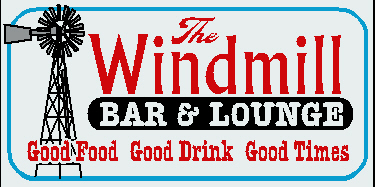

HI- I just wanted to get your opinions on my first "real" sign which I just finished and installed last weekend. Is there anything I could have done better, or anything I did horendously wrong? Let me know what you think. Here is a before and after pic-

The second one, which I presume is the one for critique, looks great for your first sign. :thumb:
On electric signs we’ve found that making the lettering stoke a little heavier improves the legibility overall. Certain fonts are more prone to be found on electric signs than others. You’ll need to find what works for you.
The other thing is, you really don’t need punctuation on a sign. The sign is not having a conversation with someone responding, so you just put the key words up for the information that they are to display.
The bottom line would work better as:
GOOD FOOD - GOOD DRINKS - GOOD TIMES

i just dont understand LOWER CASE main copy!!!!! you newbies need to stop thinking like youre writing a letter....YOU AINT. all you learned about that IS NOT USEFUL IN SIGNS...including punctuation.
what is the purpose of a sign? VISABILITY.....you want the NAME OF THE PLACE TO STAND OUT FROM ALL OTHER COPY.
also the AMPERSAND is way to large and not a good one for signage. just because it comes up in the font you are using dont mean its the one to use. i have 3-4 of them i use that look like what they sould be....repalce that element and it also dont need to be as big as the line of text it is in.

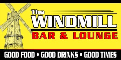

also a bolder font for main copy.... somethin in a WESTERN font would a been nicer....heres 10 min layout....see i even put in a coma...which sholdnt be there....

Good for your first sign. I would follow Gino's advice in the future as far as the punctuation goes. Also watch your word spacing - too much after the commas.
I agree to a point with OP on the capitalization. The bar name should have been in all caps, but I probably would have left the bottom tagline as upper and lower. Last thing, as Shovelhead pointed out, white space on the edges of the sign is (IMHO) a good thing. I would have left more white space all the way around it.

right...and you been at this how long?????????? and you went to how many art classes? and you can paint and draw? take the sign he did....copy it o a piece of8.5x11 paper.
do the same with mine. hang both up on the far wall from where you sit....and tell which one YOU WILL BE ABLE TO READ...at a glance......it aint pretty it aint fancy but it does the job it suppose to do....VISABILITY.. also mine was 10 min in corel....and JUST A SUGESTION.... as another way it could have been done.....

Not bad for your first, better than many I did.
There are some conflicting angles of text and I disagree about all caps, every sign legibility study done concludes that upper/lower case is best. But they don't always look good on an arch.
All caps look like a solid block from a distance.

Mixing type faces is good, more interseting than all the same, but limit it to 2 or 3. Here's my 10 minute take on it.
You did use translucent vinyl for the red, right?

I have to say I like the first one too, it has that handpainted charm too it. That being said, it is better Than my first sign too. You might also look into a subscription to Signcraft Magazine as well.
Except for the all caps comment, I agree with most of the suggestions on the punctuation, spead the tagine out and reduce it a hair....The "The" is at an odd place too but overall, very good for the first try.

I, too, thought that if this is your first (the 'before" one) then you've got it going on! The arch seems out of place as it doesn't really have a purpose, and it then creates a dead spot just below it. I also am not fond of the placement for the "THE", would like to have seen it more centralized...above the "n" would be nice. As has been said, not enough "breathing room" around the periphery. I really like the one submitted by 'billct2'

The first sign used the space really well. I think the biggest improvements you could make to yours would be using a bolder text, taking out the arch, and fixing the placement of "The". Overall its a very good sign for your first. Take the criticism with a grain of salt. Its all constructive and will help you in the long run. Keep up the good work!

Two things on an arc and italized letters and a word at an angle is way too much. You don't have to put a special effect on every line of copy. As far as the upper/lower case it could have worked with a heavier font. The word Windmill is pretty long and the upper/lower case makes it easier to read (sorry OP). It's your first sign and not too bad for a start. Get Mike Steven's book as suggested as it will be a good source to turn to and it's information is timeless so it will be a good source for years to come.
