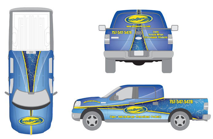

I was contacted by an out-of-state sign co. who wants to outsource their overflow work. My guess is the stuff that takes up a lot of time for quick turn-around shops such as logo design and wraps. They wanted to test my creativity before they send anything. Typically I don't usually do freebies but I'm taking a leap of faith that I will see some moolah in the future. The sample they wanted a test on was conveniently for their business. (maybe their designer was having a block and they needed an idea...I dunno I'm just hoping I don't get burned by wasting my time) Anyway, they wanted a vector design with that trendy vector/texture feel. This is what I came up with. Any feed back/constructive criticism would be great. Thanks in advance.

It's gonna be useless. You're stuck with a bad logo design to work with and you've made it so small it's going to be pointless. How big is the business name....3"? Smaller?
The stripe you're showing running over the roof doesn't match what runs down the back window. Why? You're going to end up with a butt ugly seam in the graphics that way.
I hate information being curved over the wheels. Nothing else conforms to that curve, why should the web address?
And while I'm at it I think the phone number needs to be divided up as (222) 222-2222 instead of 222-222-2222. That's just a personal preference but you asked...lol.

Hate to seem harsh, I'm usually the sensitive type, but I have to agree with Pat. It looks like a thousand other wrap designs I've seen. Did you use a template?
Kevin-shopVOX
SignManiac I like Pat's point of view. I'm thick skinned and appreciate constructive criticism. I can't think of a better place to get advice to make the work better. I didn't use a template but just some random shapes. I'm aware of the seams and probably should reverse the direction. Logo is very tough to work with but you are right I should at least give it the common courtesy of being able to be read in the parking lot. Muchas gracias amigos.

unprofessional practices aside and speaking strictly about the design... the only thing I see when I open this is the bold yellow lines. I guess I'm outta the loop cuz I dunno what "trendy vector/texture feel" is but I do know those bold, sleek lines don't mesh with the organic, flowing scroll stuff on the blue. When I have a horrible logo to work with, I emphasize the product. Beef up the product list. I'm with Pat on the curved lettering and lines not matching on roof... and why put the logo smack dab in between the doors? It's small and fits right on the door...
