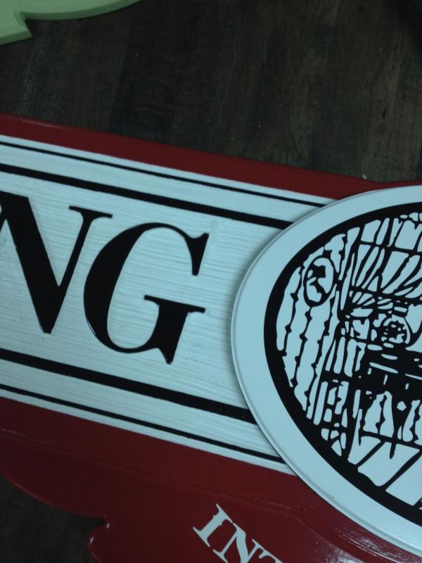

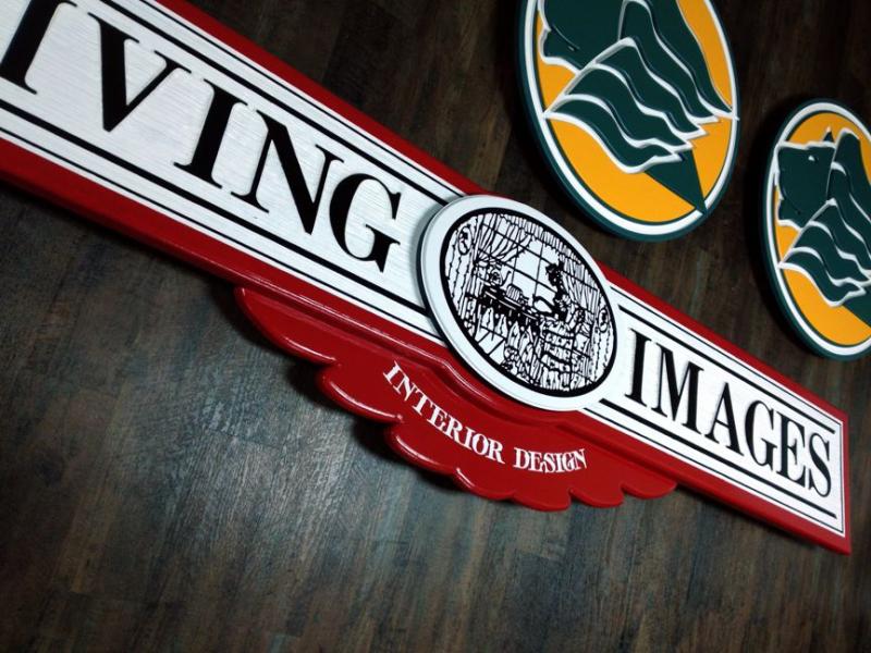

Interior or Exterior? If interior, a white semi transparent stain would do the trick but I don't think it would hold up very long out doors. If you had sandblasted the background then you could use a solid color paint and the grain would still show up beautifully. Here's one I blasted years ago and just painted. The wood grain looks better than in these pics.

I sometimes wonder if I should have just blasted these, but I like to use the CNC, since I have it... and I like the 3 layers I was able to create, which helps the fine copy & thin strokes not rise up too far off a deep blasted background, so as to look odd...
