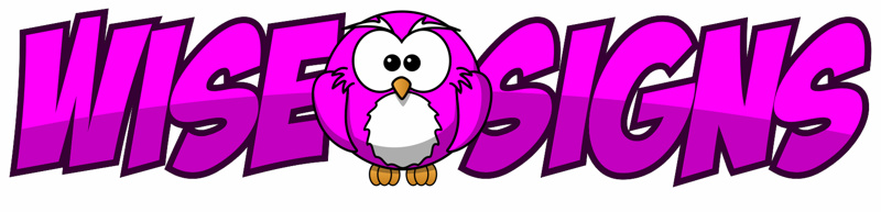

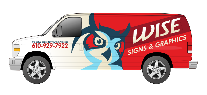

I never thought photos worked all that well with branding. You can have a stylized illustrated owl without it being "cartoonie"
Here's my attempt at making one:
Man that's killer Joe!!!!:rock-n-roll: Also, I'd go the extra mile and paint the red portion in a candy apple red! A buddy of mine just had his car painted that color and it looks fantastic.

Put Joe on your payroll...bam, done! just don't forget to add some diamond plate texture in there somewhere so it gets noticed.
:Big Laugh
Nice work, Joe!
That's pretty good. I should think it would be better if the stylized owl looked a bit less like something that just fell off a totem pole. But still nice.
Just print the whole thing on metallic silver and, as if by magic, instant candy apple. You might want to diddle the colors a bit since the white point of silver runs off into a gray tone. Most colors come out pretty much as advertised but yellows tend to look a little brassy.

Do you have a logo? I think you need to develop a logo, possibly including an illustrated owl if you want to go in that direction, and then once a clean readable logo is developed you can go onto designing an effective wrap.
and i think JOE just nailed it!!!!!
