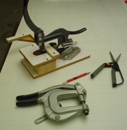

I need to get two holes into the tops of 4 small 3mm expanded PVC signs.

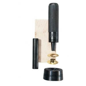

Rather than drilling them and potentially really ruining things, can I just use the hole maker from a DIY grommet kit?
(far left in sample pic)
I don't have anything to test on so I was wondering if anyone's ever tried this. I do this in coro quite easily.

Hey jill, I put grommets in that stuff all the time with the set up you are asking about, I have had no problems.
Bill
