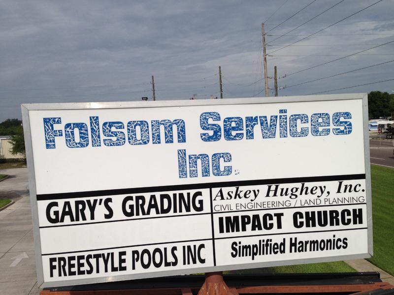

Im new to projects of this sort and hoping to get some tips. The vinyl lettering at the top of the panel has to be removed and replaced. Same lettering font ect. Any tips on how to remove the old damaged vinyl would be greatly appreciated. Pic attached

make a new panel.
Cleaning that mess is a waste of time. Plus there will be ghosts behind the letters.

Yep, its garbage. Goes to the dump. But i have a feeling that his customer wants to "save" money by reusing old panel.... make sure you explain that cleaning will cost money also so they would be better with investing in new piece of lexan.

It appears that whole panel is one. I would scrap with razor, clean with alcohol and reletter. The new design will "sorta hide" the ghosting. Judging be that lettering it will just flake off

Steamer works best with a plastic blade... glue remover a must!!! If there is residual ghosting you could always slap a layer of white translucent over the area you are working in.

if they insist on reusing, just scrap it off and don't worry about hurting it. just be careful with any chemical cleaner incase it is lexan. also include the quote for a new panel along with your qutoe to re-do this. this panel has seen it's better days and shoul be tossed.

I tried to suggest a new panel but the owner does not want to go that route and the tenant that has to top space wants their area freshened up.
Thank you for the replies I was curious about the chemicals glad I asked.

Heres my 2 cents. By the time you scrape off that old vinyl and clean the panel, your looking at quite a few man hours worth of labor. So, two ways of thinking about. Remove panel, do it the way customer wants it, and send him a bill for all the man hours. Or, purchase new panel and re-letter the whole thing and charge him accordingly. I always recommend to my customers that it will be cheaper to simply replace the panel.

Is the client aware that you will be able to see the area where the old lettering was if you reuse the panel? We've tried to re letter panels that were 18 months old, north facing and there was still a slight ghosting, i can't imagine how bad that will look when you get the old letters off!
But if they insist, plastic scraper, rapid remover and elbow grease will do the trick, but they might not like the final look.
I, personally, just did 4 panels yesterday which probably equaled your entire sign. Mine were 24" x 44" and your's looks to be about a 4' x 8' double sided. If you're only doing the top, it looks about 22" x 96". It took me about 1/2 an hour to do all four of my panels and that includes cleaning the glue off. The panels were about 10 years old.
I use a regular double edged razor blade to start. Got it all off in minutes. After finishing up all four, put some 91% alcohol on it. Let it sit about 15 seconds and scraped a little more with the razor blade. After it was rather clean, I wiped it down with a clean paper towel and 91% again and they were ready to letter in 1/2 hour. Lettered them up and the customer picked them up around 4:30.
It's not hard to re-use the old panels over. If I were to guess, with the economy the way it is..... most people are trying to re-use stock over again. If ya can't do it and do it in a reasonable amount of time, like most here are complaining, then ya might hafta start with a new substrate. As for ghosting, your new copy will probably hide it for the most part. People will be reading fresh vinyl that will stand out at 100% where the ghosting is maybe 5% at best. The new lettering will overpower that without a problem. Be finicky and make sh!t up with your customer and you can kiss the job good-bye, altogether.

It's not long for where you're at or us, since we're both around the same latitude, but he's far south of us where the sun is far greater and if that sign got direct sunlight on it all year round, it could easily look like that. I've seen trucks come in after a year or two with their hood lettering looking just like that..... using cast vinyl. Thing is, when lettering hoods, we learned to look under the hood to see if there is ample insulation or not in there.
This sign, does looks bad for 4 years, but since the OP didn't provide it, it seems the customer is not returning to the people who originally did it. It also looks like they didn't use translucent. Translucent generally doesn't react like that, but calendared does.

The customer does not want to pay for a new sign panel he only wants the top portion fixed and thinks it should be cheaper than a new one.
Yes sometimes peeling the old works but most of the time it turns out to be just as much time or more as building a new one
and they wind up with something that looks iffy.
Don't forget your overhead remains the same all the time.
I would charge the same for peeling and trying to concoct some way to make it look nice as I would for a new face.
I charge for time and effort and the "just change my sign" is usually more.
I walk away from the customer with this mentality.
When the signman agrees to change for cheap he loses and the the customer winds up with a questionable looking sign
Nobody wins

I agree with peeling it off and re-lettering it. It's not a museum piece, it's a sign.
If you are going to do it on site, I would cover the bottom portion with some backer paper and make sure you have a good seal of masking tape so no liquids or cleaners damage the bottom portion.

Scrape the old stuff off
Go fast- single edge scraper blade- keep it wet with soap & water - don't worry about scratches.
Lay down a white background with some vinyl (clear glue if it is still backlit)
Put the new text on top of that.
It will look brand new and you should be done with both sides in less than an hour.
