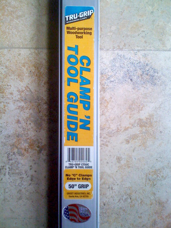

Can't offer advice on how best to cut your aluminum iSign, but here's a favorite clamp of mine. I'm sure I originally saw it on the New Yankee Workshop, at least 8 years ago, and just had to have it. Use it all the time and love it... still a sharp straight edge after all these years.
Tru-Grip Clamp & Guide
good luck with your cut!
